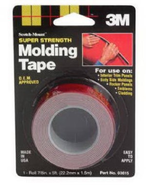

What Preparation
Originally Posted by Cearbhaill
OK- I figured out how to prep the script emblems, and managed to get them and the bumper trim on today.
What Preparation did you have to do? I know i need the 3-M tape... what do I ask for?

You need this...............
I asked for molding tape. There are a few brands available.
Is that from a automotive place or hardware?
Auto store. Usually with the paint and body supplies.

then you just apply it to the emblem and trim the excess from it?

Yes, after cutting/grinding off any prongs that exist for putting them on a '55.
It took me around an hour to prep each one. It was worth it!

I got my trim from Pep Boys. The Tape you can get at WalMart or any automotive parts store. The Chevrolet Script from Danchuck.
