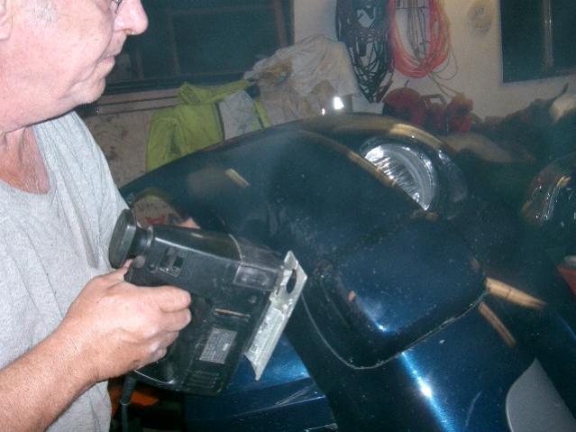

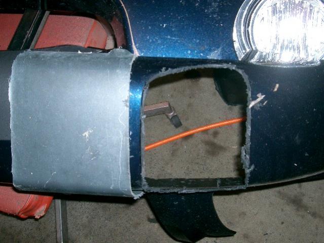

Here's video of how to repair a bumper; note the it's done from the inside.
http://www.urethanesupply.com/videofiberflex.php
I scrounged at the body shops (they seldom even try to fix bumpers) and found a piece of similarly curved bumper. I cut the 'tits' off/out with a jigsaw, cut the donor pieces to fit, and used those as inserts, (ya can heat the pieces to get 'em to fit just right) and welded them per the video above.
PM me if ya want all the details...
I guess I should do a "how to" on the mastectomy and the moulding of the lower insert...
Mo
