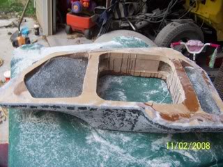

given a problem/solution basis, we wanted to keep as much cargo room as possible, and still have a good amount of bass. with our solution we will achieve this and only loose 4.5'' of usable cargo space. follow along and i will describe all materials as we go...

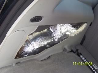

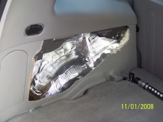

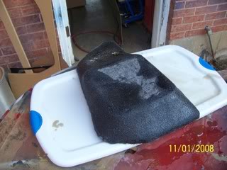

panel was removed, covered in sound absorbing material, crackes were sprayed w/ foam, covered in fiberglass matting and sealed to make sure we have an air tight enclosure

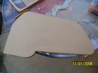

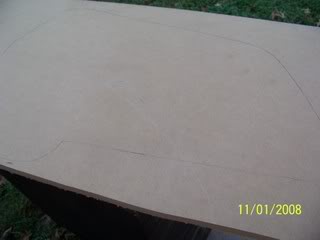

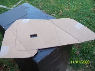

next we made a cardboard template to that we will transfer onto .75'' mdf

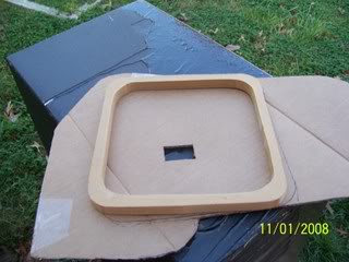

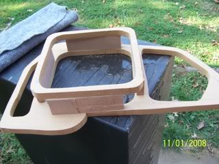

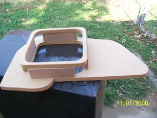

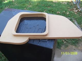

next you will cut out a speaker ring, this will be spaced out 2'' and brad nailed to the template

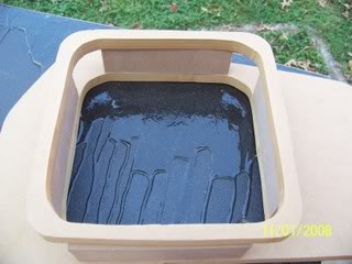

next we cut out the rest of the mdf so we will not limit valuable air space, but still have enough to mount our enclosure

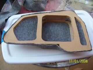

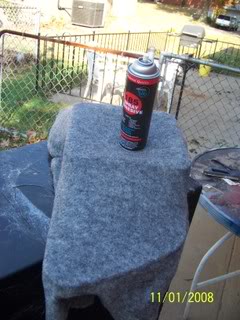

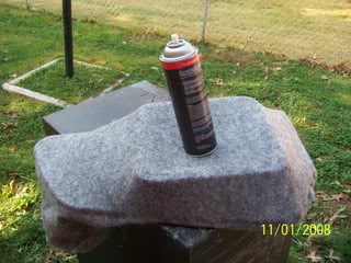

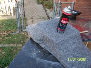

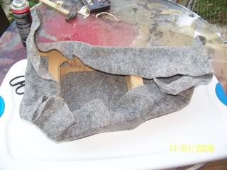

next use a piece of fleece or carpet that will strech around your project. i use spray glue to hold it tight, while i staple it all around the edges, notice how tight the fabric is, that will give you the neat shapes

this first pic is of the material all bunched up, notice though that the sides are smooth, the second pic is all the material trimmed ready for resin

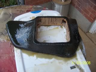

this is the project from the front covered in two nice coats of fiberglass resin,
this is the back, we filled the two holes in the side w/ material and resin to strengthen it

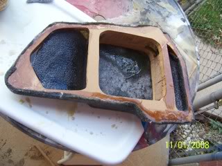

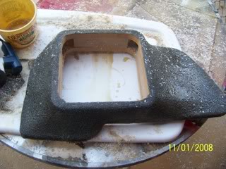

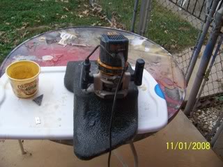

with the material so hard now, we will use a router to cut out the opening for the speaker
one final coat of resin and its ready for body work...

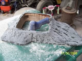

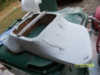

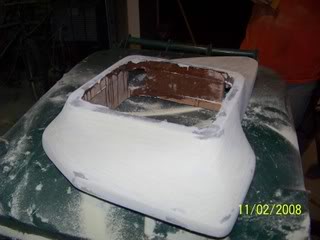

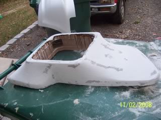

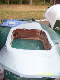

we hit it with a grinder. that will give the body filler something to stick to, at this time we also make sure the back surface is completely level

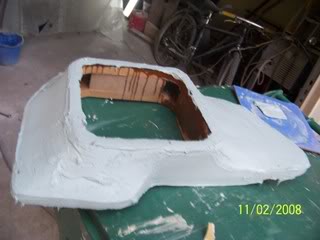

firs layer of body filler goes on, it is ready to hit w/ the cheese grater after about 10 minutes of set up time

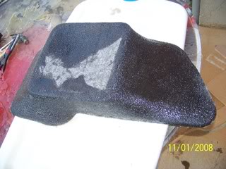

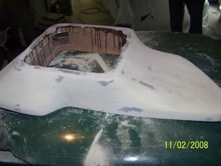

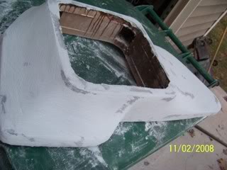

this is hit with the cheese grater and then with 36 grit sand paper, it is starting to take shape now, we will give it one more coat of body filler and then smooth it out with 80 grit sandpaper

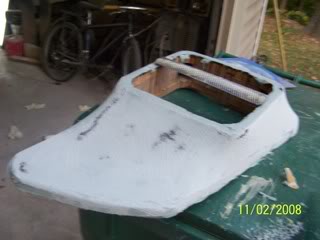

as it was getting dark we finished all the major body work. we put 3 good coats of slick sand (high build primer) and will let that dry for several hours, we will post all the finishing touches and install in the next tutorial. stay tuned!!!
