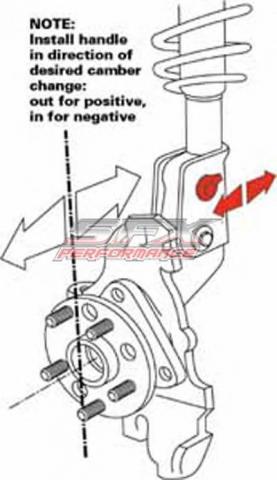

But here's a pic of the camber 'kit'..It's basically a bolt that has an off-set, & when turned changes the camber..
