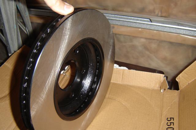

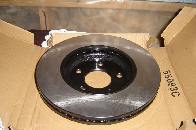

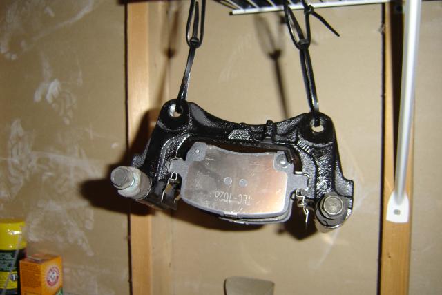

I use the GM Premium Ceramic pads listed for the HHR , aftermarket ground discs and the aforementioned used calipers brackets from LT1GMC, and the stock LS calipers, because of the size limitations of my 16 inch winter steelies and my summer WV Rally rims are also 16 inch
