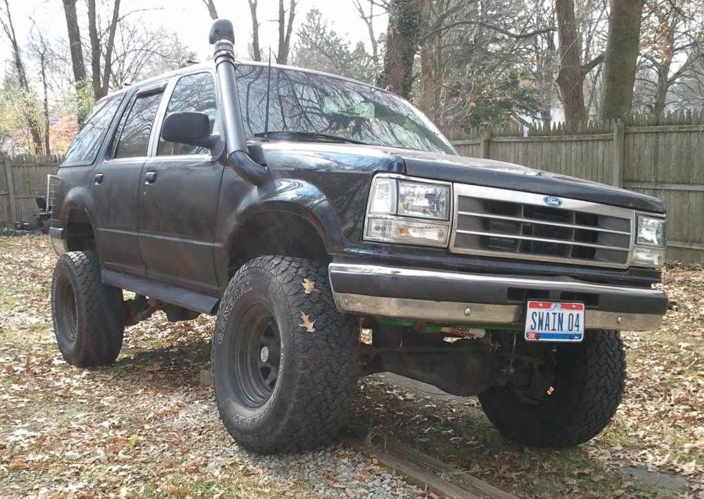

dont take me wrong i wasnt complaining, just shocked at how stiff a car ride could be.. im used to my toy, talking about stiff, it has nitrogen shocks all the way around...
