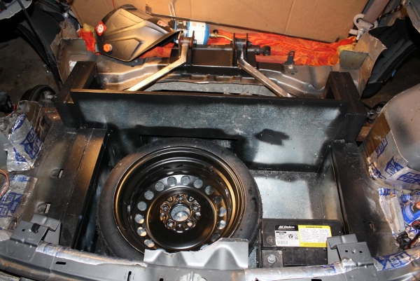

got more of the floor pan done

garagebuilt-
That is shaping up really cool... Very Wicked ride when done..
What are you using for 'sound-deadener' ? Hush-Mat or what ??
Old Dec 24, 2009 | 11:17 AM
  #34
garagebuilt's Avatar
Joined: 01-10-2006
Posts: 492
From: west columbia, texas
it was fat mat. let me tell you its way easier to put in than take out. i dont think ill put any back in. the whole pan will be carpeted so i hope thats enough. i will also be bouilding another box to go over the hole like before
