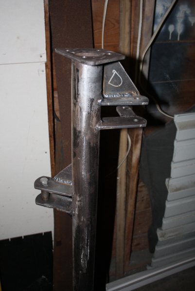

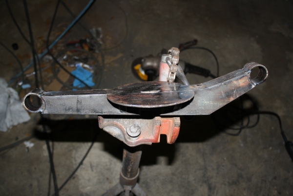

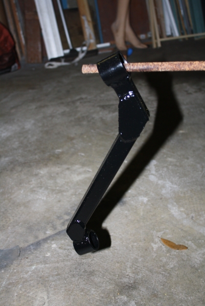

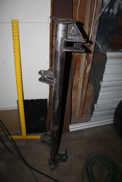

everything is welded up just needs paint

In the series of pics. above, I was wondering about the womens feets, in the first pic.They look lots better than the part. "Moon"
P.S. Being a ole Texas boy[now trplanted Cali.], I know they makes womens feets better in Texas.
