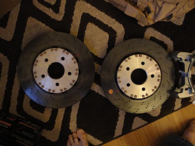

That's up to you. Personally, I wouldn't pick dimpled, slotted, or drilled rotors, but that's just me and I'm not going to be the one to (once again) open that can of worms.....

If you want the best performing get the plain. If you want the best looking get what ever dimples or slotted you like.
Avoid the drilled as they can lead to issues if driven hard. Most are not recomended for any kind of track use even the Brembo.
My SS is not a show car and a daily driver. I get discounts through work to the point I could buy the best sloted and Dimples rotors for prices most would kill for. My choice is the solids.
It is just a matter of what you want.
I like these but John say's the caliper needs modification. And I dont think I'll be going 180 on the straights
I might get to a couple shows next year, but I would rather stop good than look cool. I will get the premium solid ones,
thanks for the advice.
