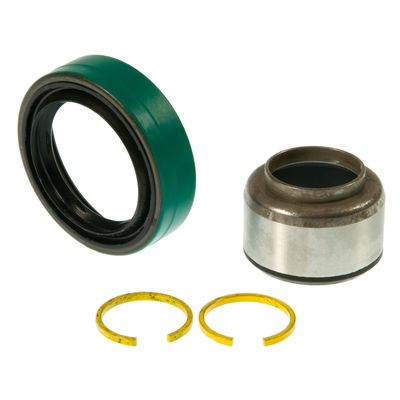

That's what I did in my case; i.e., I just replaced the outer seal. Note, I had to buy an aftermarket seal at RockAuto because although I dug around and found the GM part number for just the outer seal (#24201936), GM doesn't sell just the seal. Instead, they sell the seal kit, which also comes with the stub shaft portion (kit is around $30 (whoa!)). I didn't need the latter, so I instead shopped for just the aftermarket outer seal on RockAuto and paid just under $10. It installed perfectly.
i found this one at advanced auto but it comes with seal and the inter cup for 15$ is the the right one 2007 lt 2 auto
National Transmission Seal

I can't say if that's the right one for the LT car. Mine is SS. I might guess they are the same, but I don't want to lead you astray. Somebody else will have to chime in to say for sure.

my is a auto 4T45E ..

Ding, ding! Looks like that's the same as mine. I also have the 4T45E. Thus, the Advanced Auto part looks like it should work. Note again though, you can buy just the outer seal at RockAuto for less money.
If you intend to replace the stub shaft sleeve/seal, I think you'll need to get the special tool. But honestly, I've never replaced the stub shaft sleeve/seal, so I can't say if there's a workaround to avoid buying the special tool.
