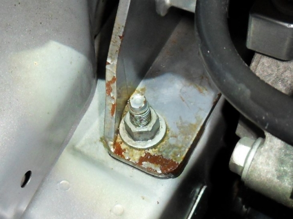

Old Oct 11, 2015 | 11:08 AM
  #120
rlee63a4's Avatar
Joined: 07-06-2011
Posts: 95
From: Bellbrook OH
After 15,000 miles, motor mount still functioning as advertised, but powder coating flaking off.
