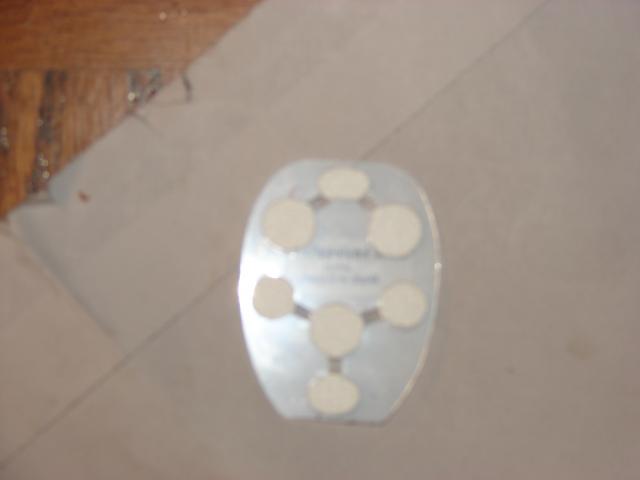

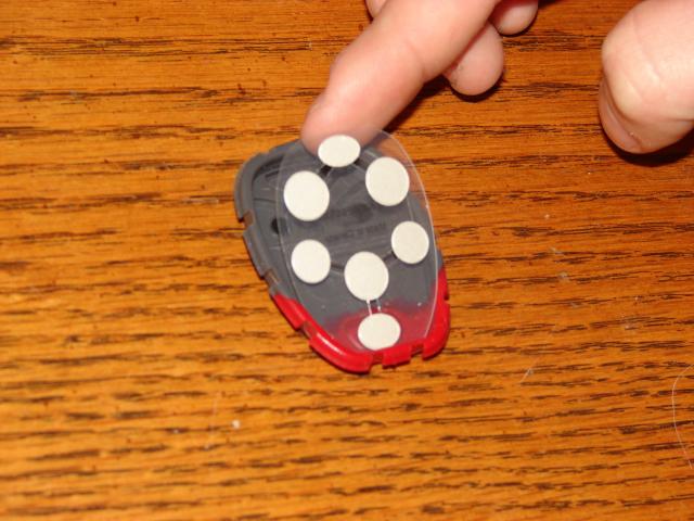

if its not the battery solder joint I would bet its the buttons. I have fixed many of these with this little jem from keylessfix.com It works very well it cost about 10.00 and no programing needed. It replaces the contacts on the buttons
