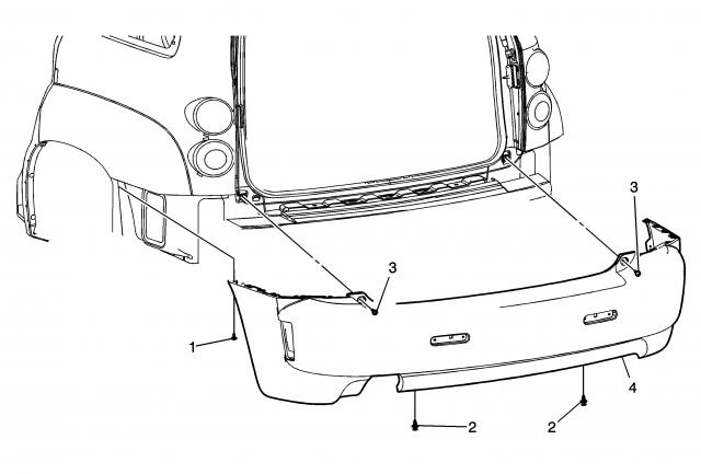

The bumper cover is not fasten on by much. My guess is the it my have pulled some fasteners out. Here is a view of the bumper cover

The cover is rubber, Styrofoam under it.

Welcome to the forum. When I got hit in the back the repair shop said that if the styroform is compresser they would have to replace the rear cover. You might want to check that.

Many have found that the Styrofoam often goes missing.
