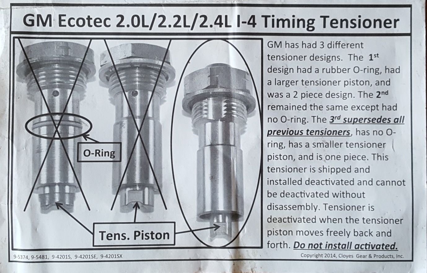

Versions or part numbers?
I found the sheet Cloyes sent with the kit last year. The upper half of it explains chain markings.
My memory was accurate but I probably misread the sheet back when. I was seeing two tensioners with humps. Now I can’t tell if the second one has it. I’m thinking probably not.
The notes on the photo are theirs, not mine. No part numbers, obviously.

" the third supersedes ALL previous tensioners" Look closely 2 of them have a tiny hole, 1 needs an O-ring, the third has a groove in the threads. The first 2 have a large piston the third a smaller one.
To answer the OP "Tensioner is deactivated when the tensioner piston moves freely".

I like the hump. You can identify it by feel and confirm a car has the latest version. Until the next version. Then what, two humps? We’ll need to call it the camel.

Every 2.4L had the "newest". My 2008 2.2 had #2. I suspect that #1 goes in the wayback bucket, like Cavalier days.
That makes sense to me when I surmise that the older one was not up to the demands of VVT, and then they realized the new one was better even in non-VVT motors.
My 2008 2.4 had the hump on the tensioner and I was confused because it was well rusted and I was pretty sure at 80K the chains had never been done. This clears it up.
