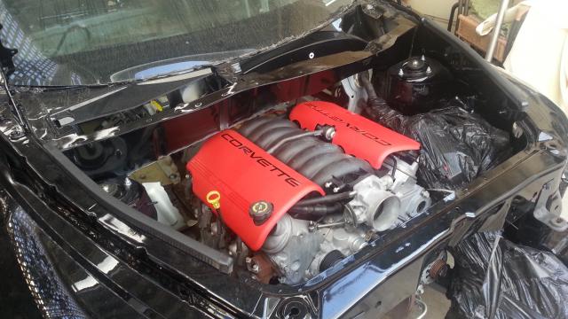

Working on things that are very important but really doesn't look like much. I'm making a new rear trans mount, the original is too low. I don't want to be leaving my trans pan on some bump I go over. I have to wait a couple of days to use my friends Bridgeport to machine the holes in the spindles for the tie rod inserts so I can't do that just yet. I thought I would post a photo of the engine with the fuel rail covers on. They even match the seats and door panels.

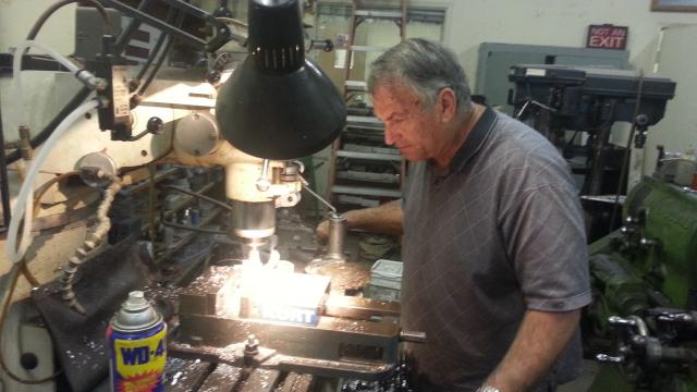

lasater, Is that you at the lathe?
Yeah, I dabble in a little bit of half-assed machine work.

To bad those fuel rail covers don't say HHR.
Old Dec 23, 2013 | 09:15 PM
  #65
Lucky's Avatar
Joined: 12-24-2007
Posts: 2,873
From: Seville. OH
The cover saying hhr would be nice but how wouldn't want to brag about having a corvette engine in your hhr . Looks good to me

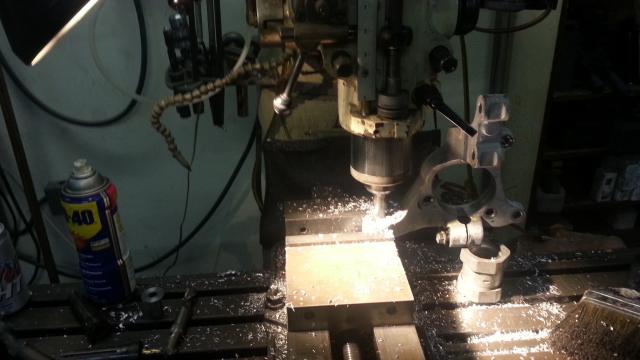

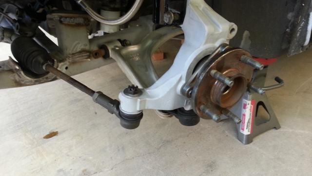

Well my half baked idea to flip the tie rods upside down seems to work. I used my buddies Bridgeport mill and machined 3/4" hole where the tapered hole once was. I also milled off 3/16" off the thickness to compensate for the two ends of the steel insert I made to make the tapered hole go the other way. I soda blasted the whole spindle assembly and shortened and threaded the Camaro tie rods another 1/2". This gives me enough adjustment for the correct toe in.

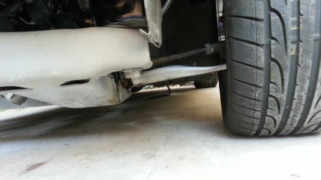

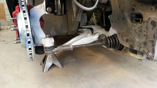

Here is a couple of pics of the tie rod assembly complete. When I lower the front of the car with the air struts to it's lowest point I would ever drive the car it still keeps an acceptable angle on the tie rod. (which by the way is 4" of clearance under the engine cradle) Tomorrow I will be pulling the rear axles out to swap the Camaro brakes right to left so that I get a better line up with the HHR parking brake cables. I'll post more pics then...it will make more sense when you see it.
