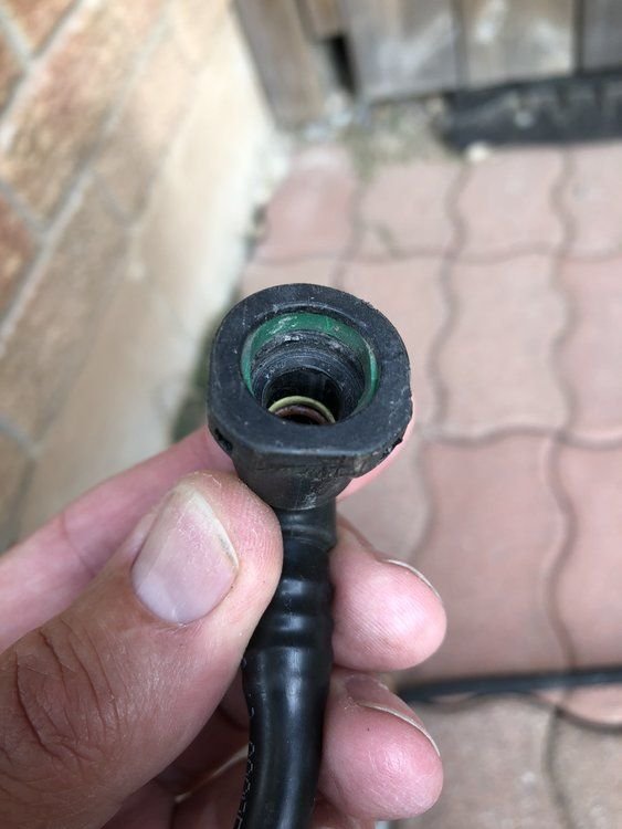

What the heck is this?
I think the thread should be renamed to "What Did Your HHR Do To You Today?"
So anywho...what the heck is this?

This is the EVAP canister end of the vapour line , you simply squeeze the flat area and the rounded area gently together with pliers and remove from the plastic tube it’s attached to

Well if you look at my pic closely you will see it's cut off and the green plastic on the inside is broken. Was this part of the fuel line? I'm sorry I know nothing about this kind of stuff.
https://www.chevyhhr.net/forums/prob...k-63571/page2/
Look at the thread above. Posts #19, 20.

That’s the engine end, it has a white retaining clip and is 8 mm , the connector Ronnie has is the under car EVAP end with the green retainer clip and is 10 mm
it is most likely just the discarded part from the $110.00 fuel line repairs Ronnie just had done, by the mobile mechanic.
