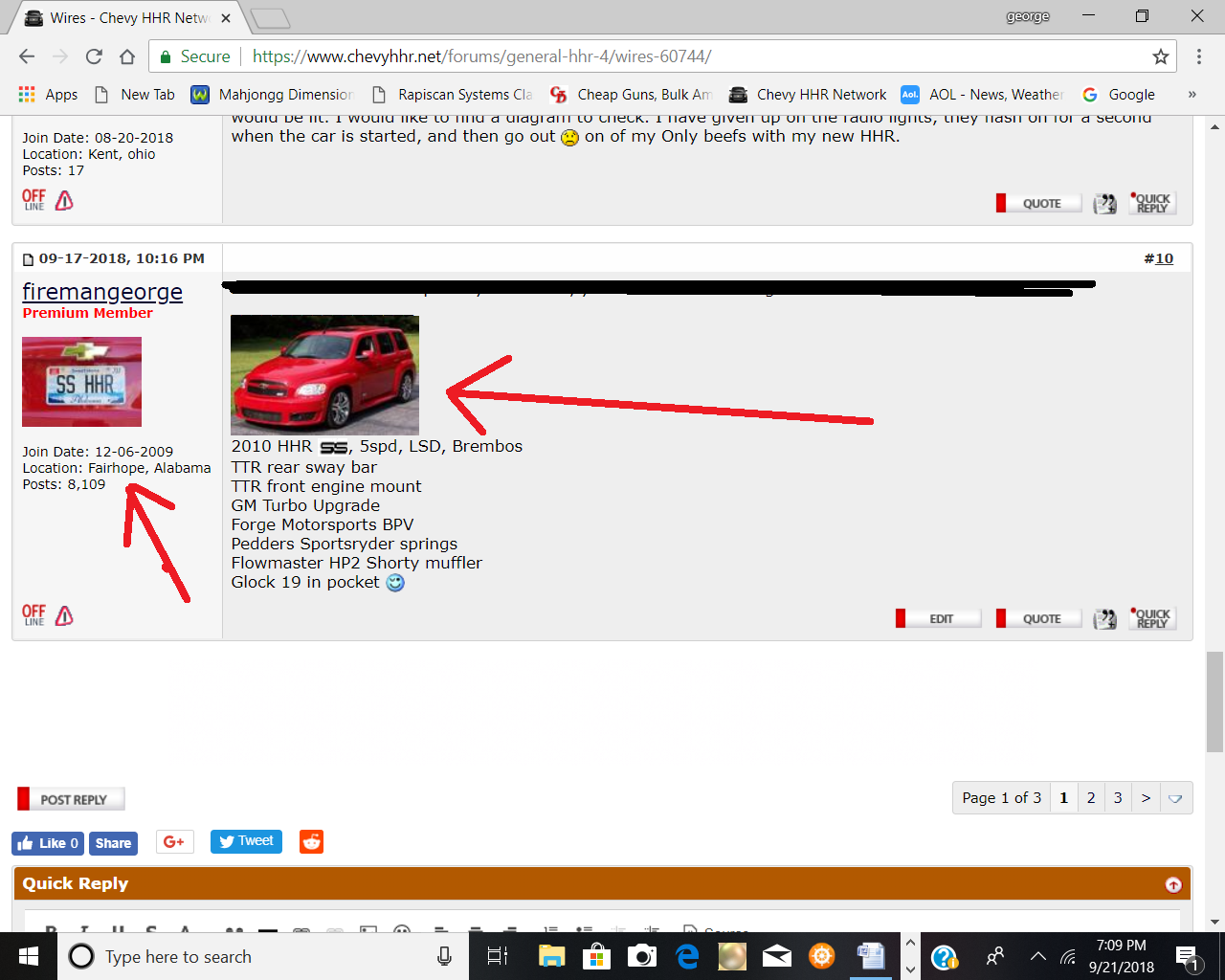

One last question, how do you get a picture under your log in name. My rig is a 2008, and is the same color as yours :)

Premium membership is needed to put an avatar picture under your user name. And it's available for the mods and administrator.
I think every member can put a picture in the other spot where your post is.
