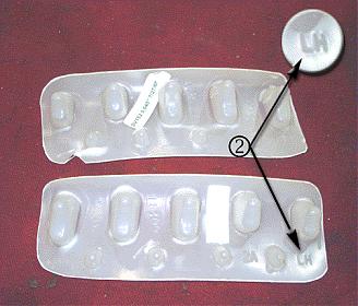

When this recall was released I ran all the VIN's on our used car lot and found 3 that needed the recall. I asked the parts manager to order 20 kits (left and right) on that same day knowing the notices would be mailed soon. I am in Dallas and the majority of our parts come from the Fort Worth warehouse, which is 30 miles away.
When he ordered the kits Fort Worth showed to have 1200 in their inventory. Normally if we order on a Tuesday from Fort Worth they come in on Wednesday. Not so with this order. The order was cancelled out of Fort Worth and it took GM 4 working days to get them here from another warehouse.
The first 3 boxes that we opened had 2 left hand (drivers side) pads. After opening all of the boxes we found that 11 of the 20 had left hand only.

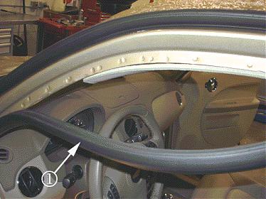

Originally Posted by JeffsHHR
Please post pics of what they do to it. thanks.
Remove the door weatherstrip

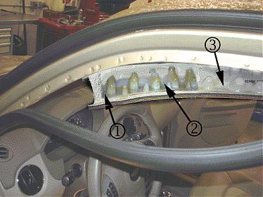

Locate the installation point for installing the energy absorbing (EA) plastic piece (2) onto the A-pillar edge (1) of the headliner (3).

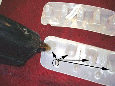

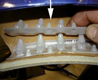

Apply hot glue to the energy absorbing (EA) plastic piece pocket areas (1).
