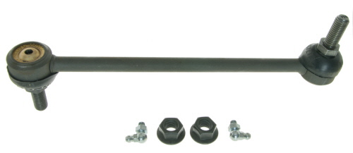

interesting on the end links! I was searching for them for my SS when i saw your post, did the 750012 have the zerk fittings for greasing? I am not saying you have the wrong part, I am just going by what I am seeing on Rock Auto website. maybe one of the part numbers does NOT have the zerk fittings, I dont know for sure, if anyone can clarify that would be great!
BTW welcome to the site and nice score!!
K750012 definitely has the zerk fittings for greasing, but I'm not sure about K750428. They way I posted the PNs and descriptions in my last post is exactly the way they are listed on Moogs website. I can tell you that if you click on the PNs and bring up the photos, both PNs show the zerk fittings, but I did think it was interesting that they did not describe K750428 as a "Problem Solver" and did not mention the "powdered metal gusher bearing to allow grease to penetrate bearing surfaces", like they did for the other two PNs. I'd think that if K75028 had those features, they mention it in the the description, like they did for the other PNs.

Here's the pics from Moogs website.
K750012
K750428
K80252

OK, I had the RH front wheel off to replace a tire pressure sensor(What a pain in the butt those are!) and I went ahead and replaced the RH sway bar end link. Now all my front end noises are 100% gone. When I hit a bump now, its dead silence! While I had the old one off, I compared it with the new one(Moog K750012). The new one is exactly the same length and the studs on the ends are the same size. The only difference is that the Moog piece is much beefier. I also double checked and there is indeed a spacer/washer on the upper mount that looks just like the one in the photo of Moog K750428 that I posted above. At this point, I'm assuming that this spacer/washer is the only difference between Moog K750012 and K750428, and that K80252 is too long. Part# K750012 seems to be much more common and is therefore cheaper. My conclusion is that you can use either K750012 or K750428 on any HHR and that the only time K750428 would be important, would be that if you had a SS strut and didn't have the spacer/washer for some reason. If anybody finds out something different, please let me know.
