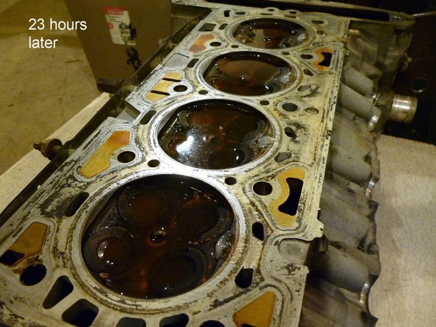

Here are my findings from the combustion chamber leak test.
Having done nothing to the valves and seats, I re-installed them, installed the spark plugs, plugged the injector holes w/glob of grease, and leveled the head. I then filled the combustion chambers w/washer fluid and let it set. The pictures below show the time progression. You can see that leakage is extremely slow, which tells me the valve seat seal is fairly decent. Most of the leakage, although small as shown in the pictures, was through the intake valves; a tiny amount seeped through a few exhaust valves. But over time, it was very minimal overall. Therefore valve lapping should be acceptable and have a negligible effect on the combustion pressure; i.e., I should not end up creating excess blow-by around the piston rings. I'm curious to hear your thoughts.
