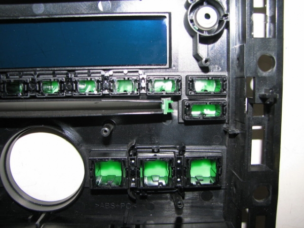

3) In the 2009-year radio the color of the buttons is basically controlled by the color of the Green translucent button plastic, not by the LED color. Some interesting combinations could occur, but would have to be experimented with for color and intensity. The “presumably” white light from the 2009 model year LEDs is transmitted through clear plastic light guides that direct the light through holes in the PCB to the buttons, knobs and CD slot.

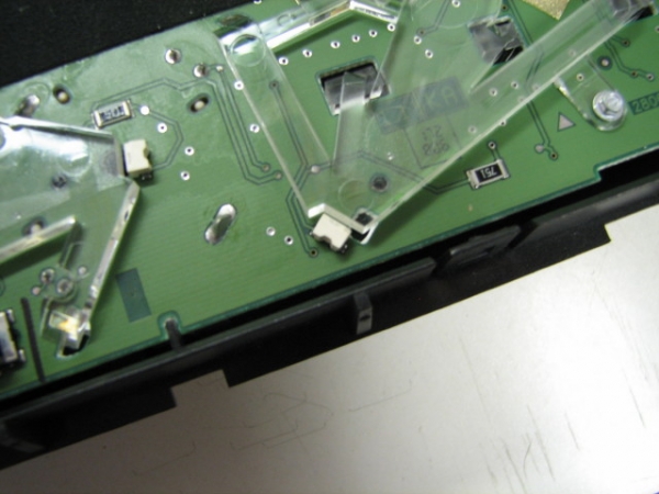

Some Pics:
Faceplate
Light Guides
Close Up Light Guide & LEDs
Green Button Interior
Knob Side of PCB

Some Pics:
Faceplate
Light Guides
Knob Side of PCB

Thanks for that info. I thought they would be the same way? That kinda limits your ability to modify it. I mean you can still get the LED's, they would just have to be different. Have you powered it up so you can see what color the LED's are? Just wondering. You would have to micrometer them and then try to match the style at mouser.com to find the proper ones. I would still use the manufacturer Lite-On. They make great quality stuff. The green buttons could be change out, possibly with a faceplate of an earlier one. I believe this was the same. I wonder about that. Because the 2006-2008 have only white ones an their LED's were color diffused.
Thanks for the info. I definately learned something.
I am only "presuming" the 2009 radio LEDs are white. The faceplate has to be attached to the radio unit to power the faceplate and I wasn't interested in taking the time to hook up some jumpers and resistors to power the LEDs. Wasn’t what I was doing and I don't like very small stuff. Yeah, I know 30 gauge wire wrap wire is small, but in my case necessary.
