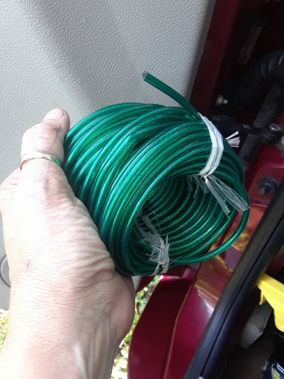

FYI. The drain tubes make a 90 degree turn at the door pillars. Your weed eater line may not be able to make that tight turn.
It's very possible. I wanted to use the stiffer weed eater line to break through the clog. I guess I need to see if he has any other kind.
Thanks for the tip!

Try from the bottom up. Be careful, some have dislocated the 90.
Old Aug 7, 2020 | 05:51 PM
Ronnie's Avatar
Joined: 02-23-2020
Posts: 518
From: Kansas
I bought clothesline wire. It's pretty flexible but yet sturdy. I went down through the top and then up through the bottom. I took the cover off the bottom end of the line to make it easier for me. It's not necessary to get the line through.
Both sides are wide open now!
