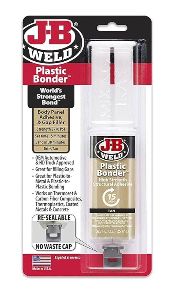

This was interesting, but never tried the stuff: https://www.gluegun.com/blogs/news/b...20the%20market.
Also, without endorsement, (but I've had nothing but success with the Loctite, in several situations):
Old Apr 21, 2024 | 04:22 PM
Posts: 40,088
It’s a gamble, I haven’t had success gluing plastic together, except my model cars when I was younger
Old Apr 21, 2024 | 10:29 PM
Posts: 26,536
Plumber's GOOP sticks to most all plastics.
