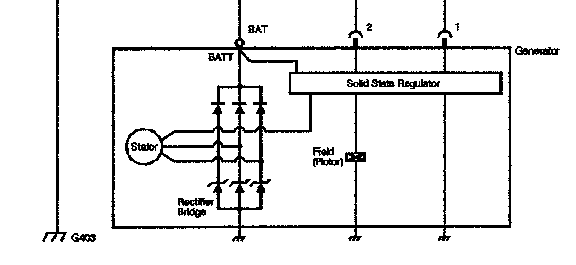

The HHR does have an internally regulated alternator. Regardless of what GM calls it, it is an alternator with a rotor, a stator, and a rectifier bridge; items you wouldn't find in a generator.
File Type: bmp

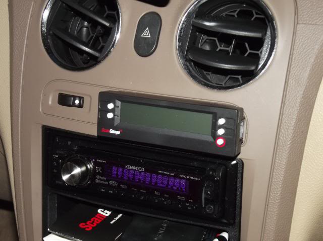

Instead of a single gauge I got a Scan Gauge II and mounted it over the airbag light. Besides being able to monitor my voltage, I can read things like MPG,intake temp,throttle position sensor,coolant temp. and the list goes on. Also if I have a code that comes up ,I can read it and clear it also.

Nice, would look cool in the pocket under the radio IMO.
