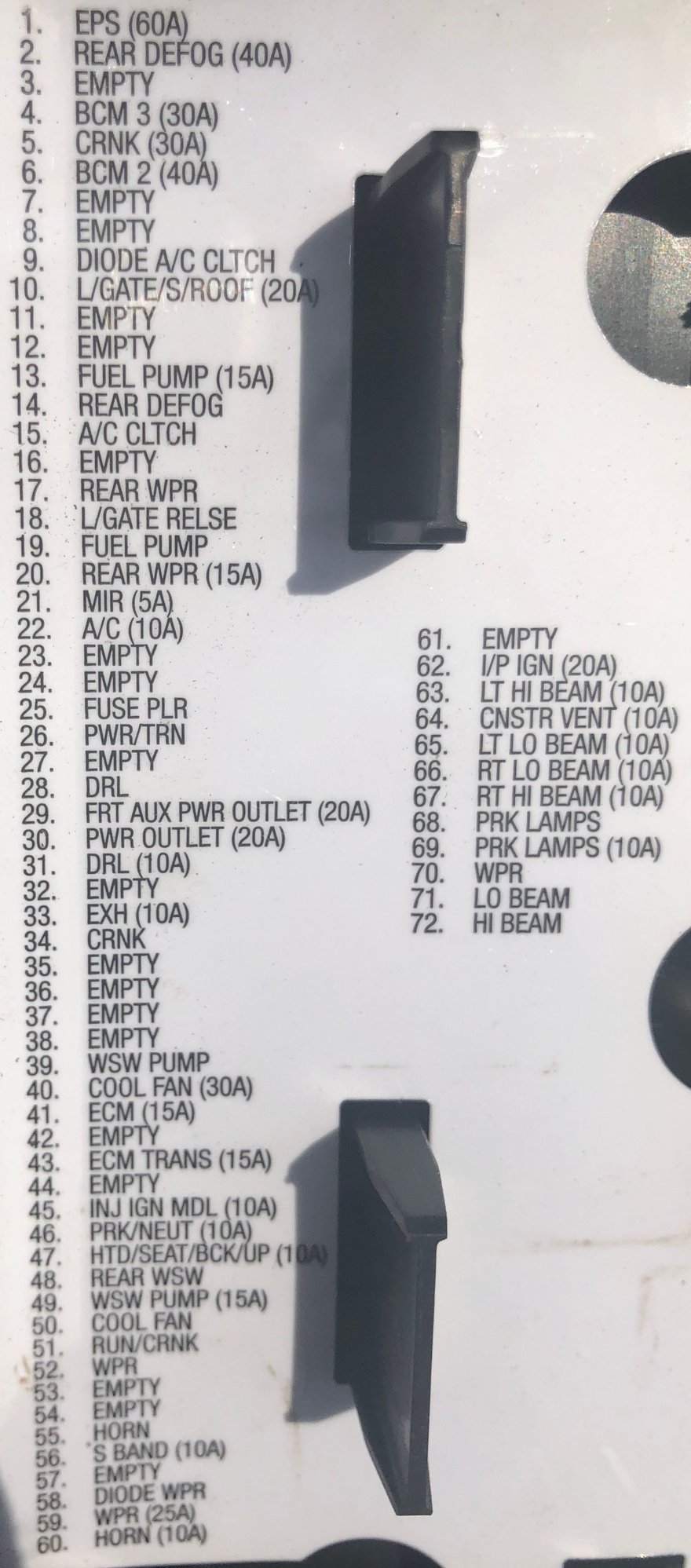

I feel that part of the system is just not getting power. I've checked every connection at the BCM and in the fuse box. I'm attaching photos of each panel and the keys for each as well.
I've found several fuses that are not getting power no matter if the key is on acc, run, or off. These are as follows:
Fuse Box: 33, 41, 43, 45, 46, 47, 62, 63, 65, 66, & 67.
BCM: 13, 15, 16, & 19
In the fuse box, I found that fuse 31 is the only one that goes to ground. In the BCM, fuse 28 goes to ground but only when the ignition is on acc or run.
Additionally, I cannot get any of the following to work:
Rear defog
Front wipers
Horn
Headlights
Blinkers/Hazards
Backup lights
Power Mirrors
Everything worked before it went to heck, and everything else still seems to work as expected. Does the BCM control anything that would stop power from being applied?
