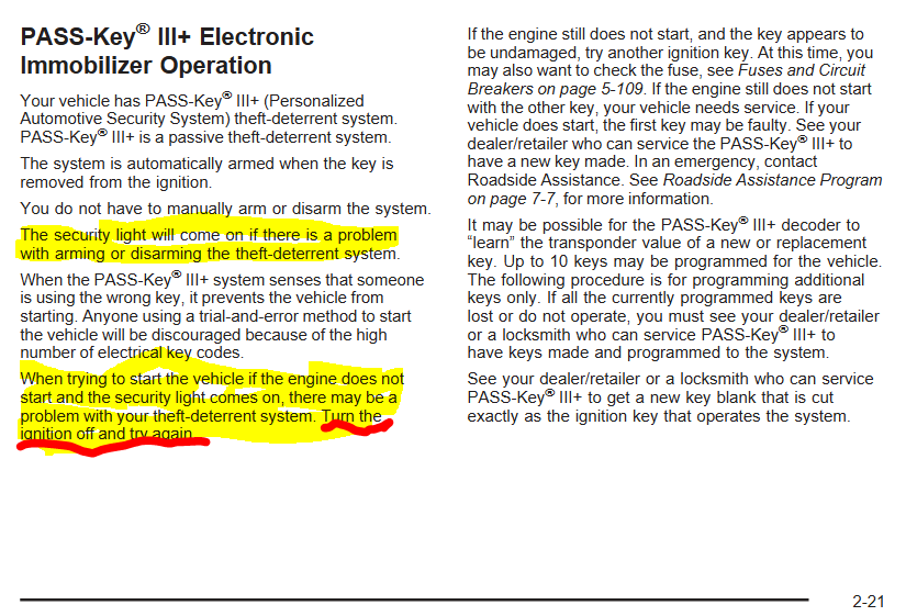

Old Mar 20, 2017 | 09:27 PM
Posts: 26,532
It should go out the second time you start it after a dead battery event.
When the battery goes below a certain threshold the car goes into anti-theft mode; the key is locked in the ignition and the doors lock and the theft light goes on.
From page 2-21 in your Owner Manual:
