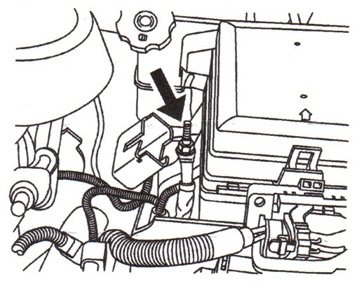

I agree have the battery checked. Also check this connection at the under hood fuse box. They are know to loosen up over time.

Thanks Lucky, I knew there was another possibility, but I "spaced" on the underhood connection.
