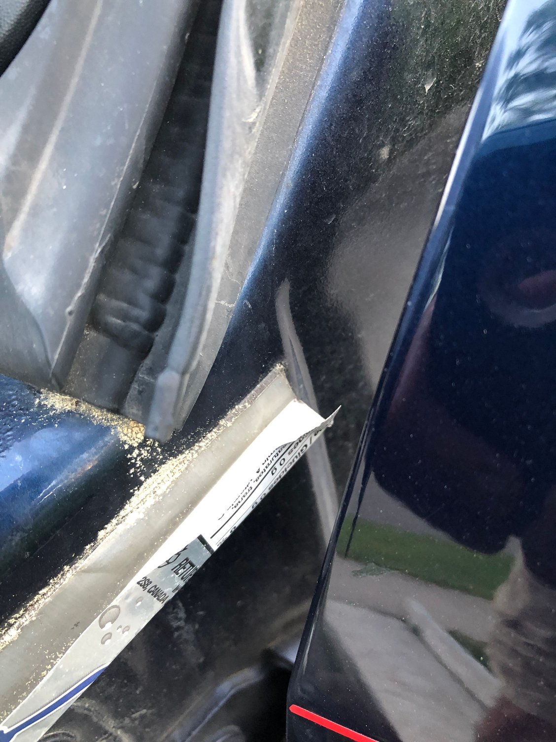

try a trough to divert the water in front of the fender
Like this from Oldblue
Passenger side, see how the water is diverted
Just a 3/8 inch trough , I bent up a Soda can and used 3M double sided molding tape
Here’s a better shot of the drivers side and the front of the trough, up here it keeps water from causing ice dams in the door hinge area and the wiring harness boot area.
