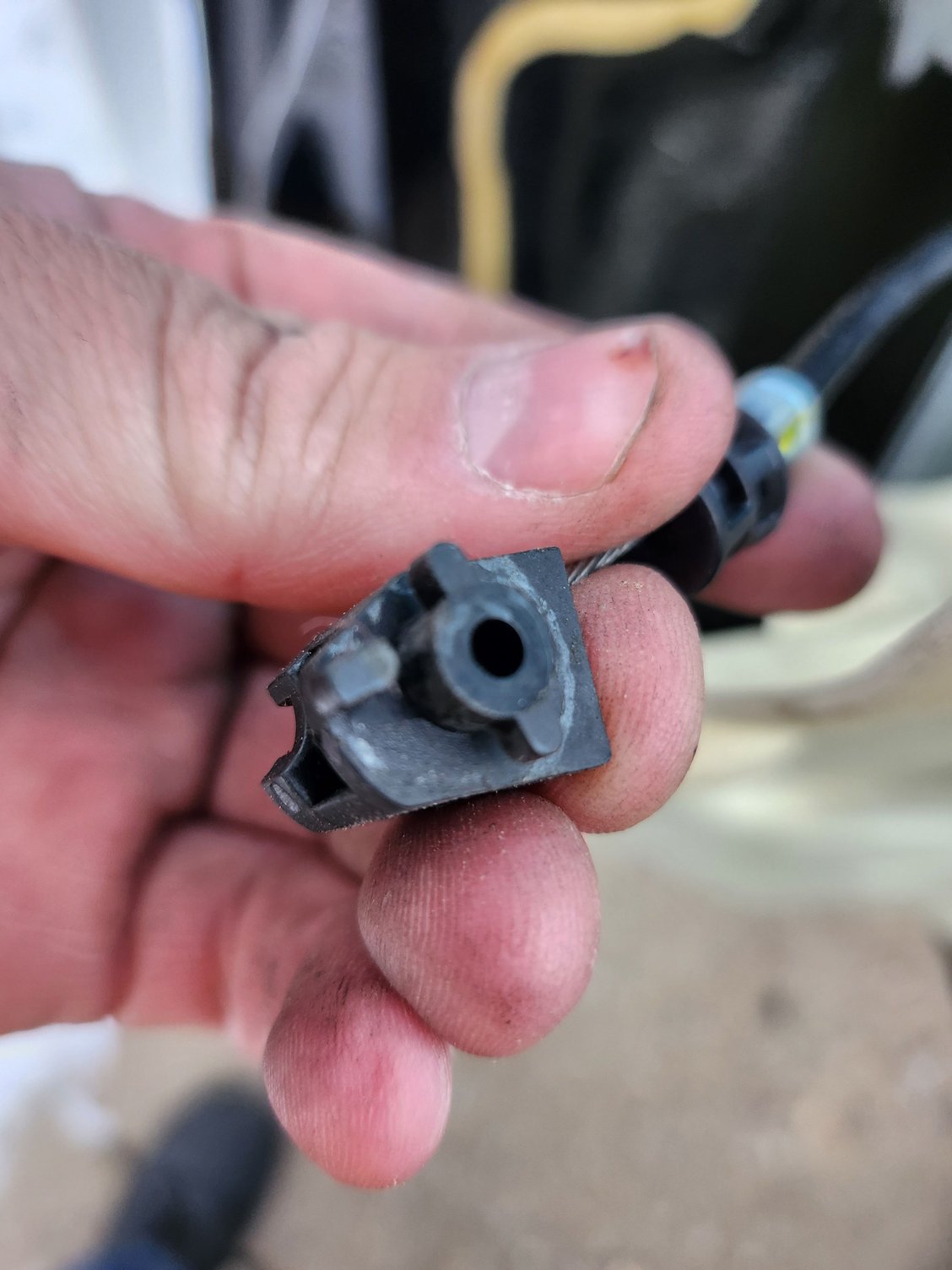

I got the latch mechanism out of the door. The cable looks intact to me. But the plastic piece that connects the cable to the mechanism won't stay connected. Here's a couple pictures.
Broken little plastic piece here. Doesn't seem like it would keep it in place.

Posts: 40,088
The tab that broke off holds the cable end into position, try a tywrap through the hole in the cable end and around the metal lever it fits into or a piece of mechanics wire.
I was running out of daylight, so I put it all back together and it's holding for the moment. I'm sure I'm just one hard close away from it coming apart again, but I'll probably wait until then. Depending on what I find at the yard, I might just go with your suggestion. These are getting old enough that the plastic parts are starting to dry out and get brittle. So a used factory part might not last as long as a zip tie.
