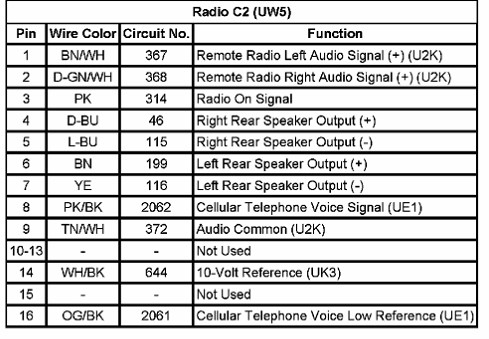

According to the wiring schematic the pink wire carries a "radio on signal", so my guess is it would be the same as a "mast up/down signal".

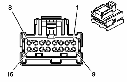

Oh, you are looking for the radio end of the pink wire?
That runs up the passenger side A frame right next to the coax, it is probably in the big plug that you disconnected to get to the speaker and power wires. Not he speaker connector the other one with power.

Thanks donbrew, yes, I was looking for the radio end of the pink wire so I can attach the new head unit's power antenna wire to the pink wire. Glad to hear that it's on the plug, that will make it easy to find.
Thanks again for the help, that's exactly what I was looking for.
