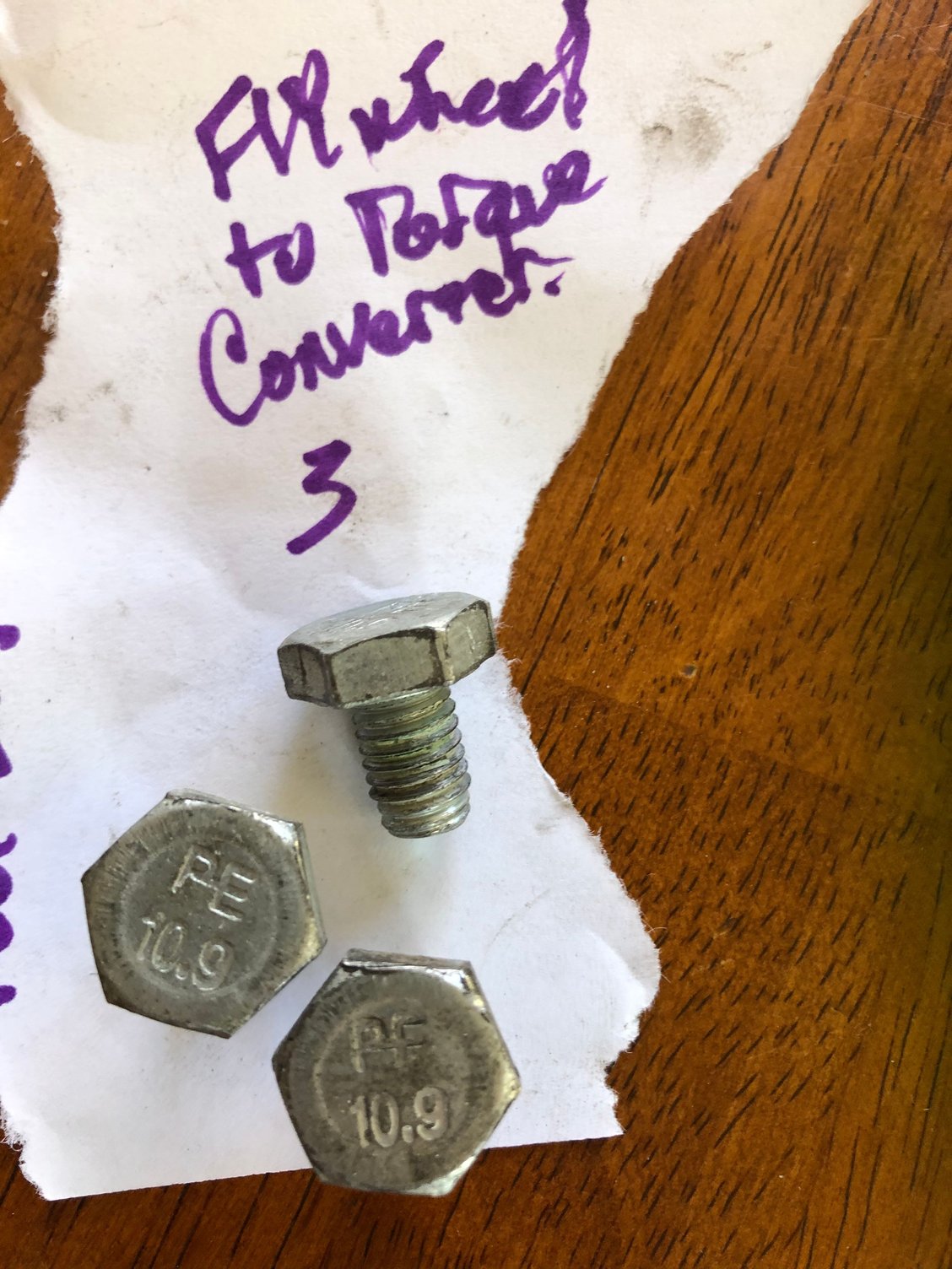

If your bolts look like these, a M10x1.5 (Grade 10.9) would be torqued to 75 Nm or 55 lb/ft.

my look like...

Clean those threads , a drop or blue Loctite and use them again
