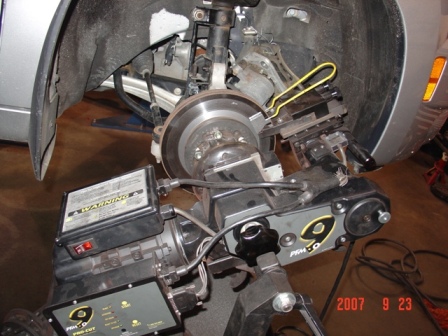

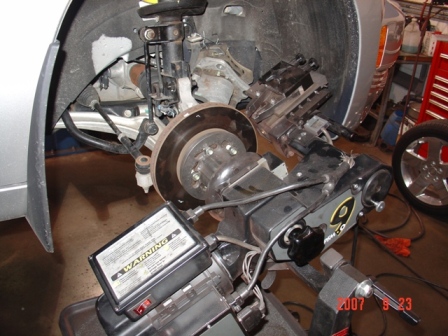

yes cleaning the rotors of the rust will make difference, but if the rotors are turned off the car the vibration problem could come back soon.Also if your rotors are turned more than twice they will more than likley need to be replaced. If they get too thin they will warp due to the heat. here are pics of how they should be turned on the car.

[QUOTE=ballplr;200779].Also if your rotors are turned more than twice they will more than likely need to be replaced. QUOTE]
I heard that brake rotors can only be turned once not twice. However, I fully admit that anyone that knows about the pictured gizmo has forgotten more than I ever knew! Interesting stuff. Thanks.
