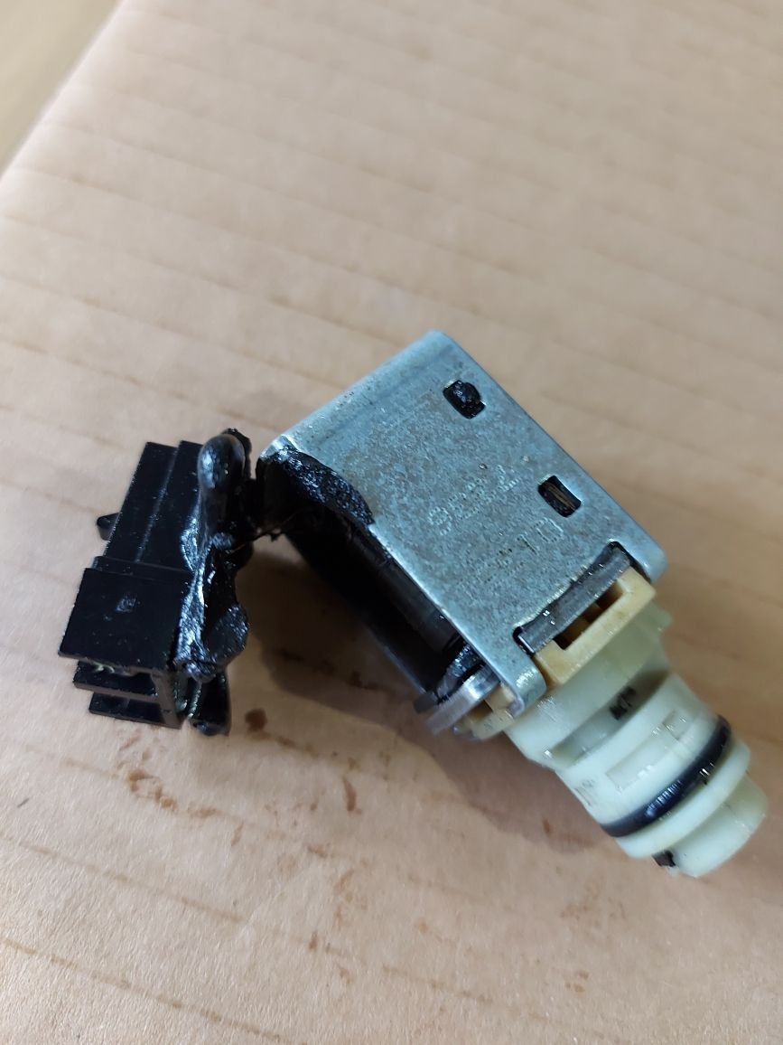

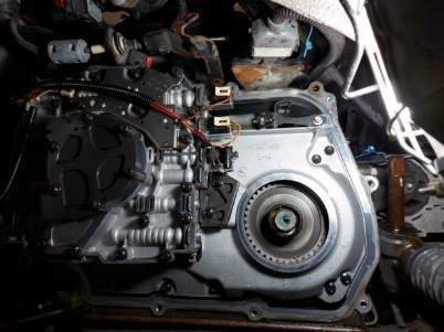

Not a hard job to drop the cradle on the driver’s side and remove the side pan
The second one down fried , but we replaced both.
You can see here the cradle comes down a couple of inches you need to disconnect the steering yoke. the_shmoo and I did the job in 5 or 6 hours. Jack stands and floor jack If handsome and you’re handy you can do this.

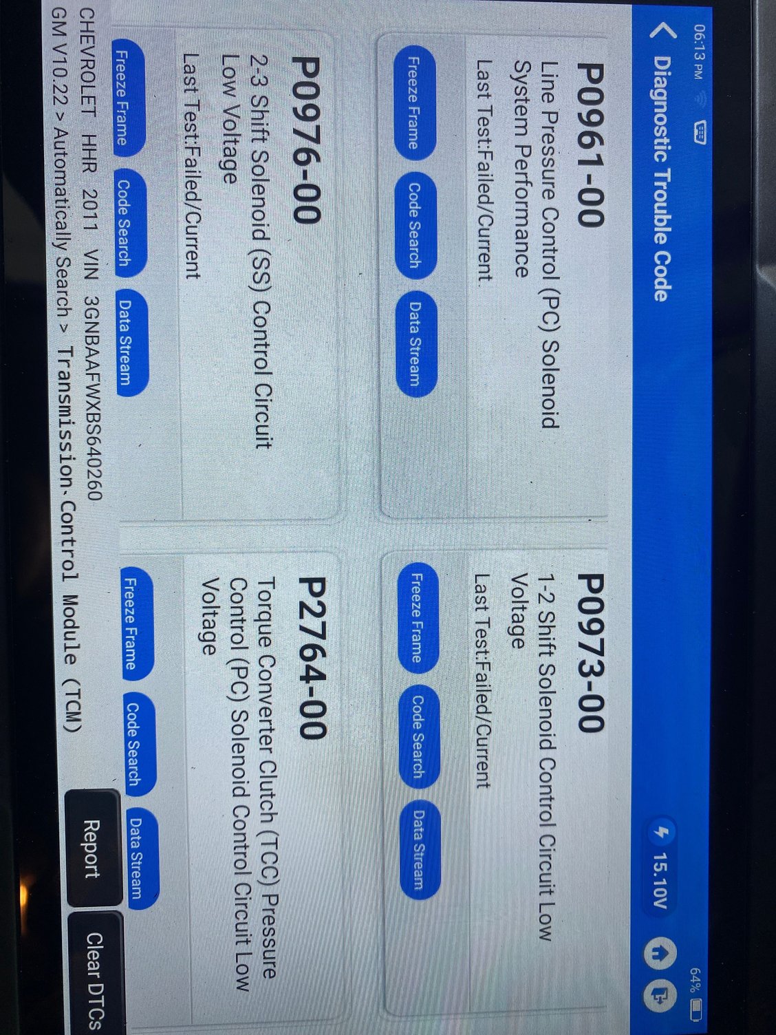

Okay got the new module in. Same issues but this time I actually got codes where as before I had none. So I am going from there

Yep, drop the cradle and transmission, replace the solenoids
A fairly easy job
