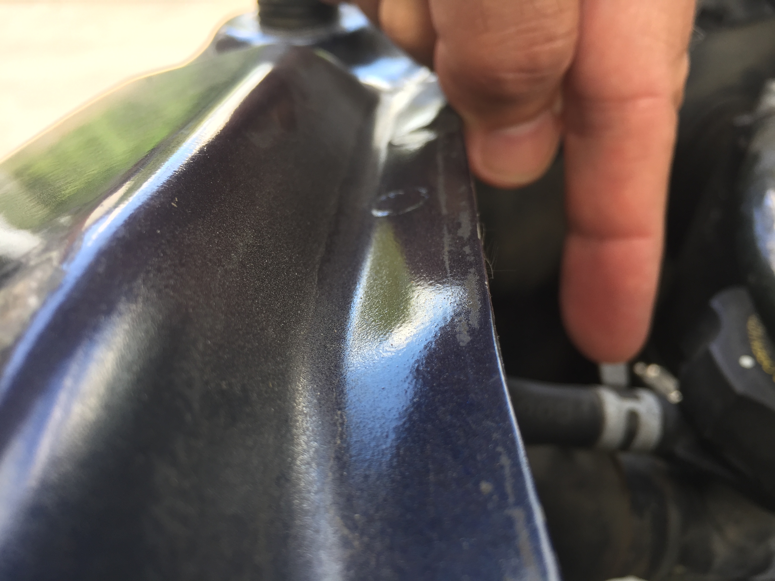

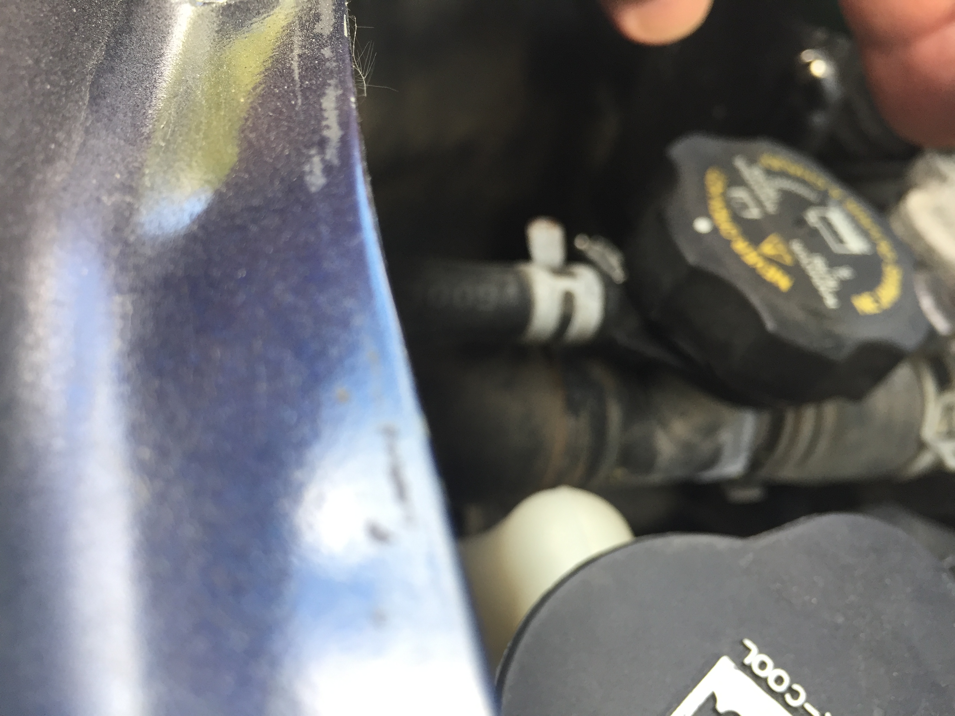

Old Aug 16, 2017 | 09:44 AM
Posts: 40,083
And if the cap is weak and won't hold 15 psi then it'll allow Dexcool past it! Here
Attached Thumbnails HHR overheating-img_0676.jpg   HHR overheating-img_0675.jpg
