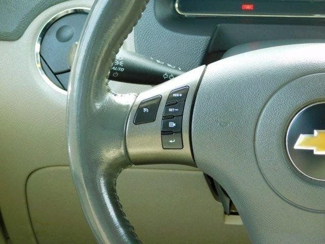

You scroll through the DIC using the buttons on the left side of the steering wheel, the second from the bottom.

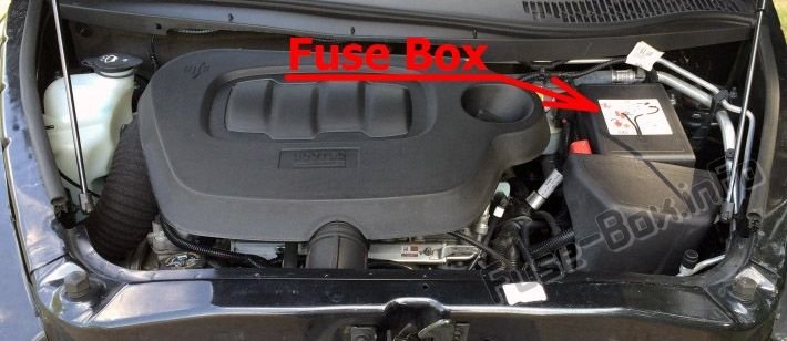

I saw a battery in the back one time when I was looking around in the HHR. It looks like a typical car battery and thought it got recharged automatically along with the battery under the hood. Is that true or do I have to recharge that with a recharger? Why would it be dead?
Old Feb 10, 2022 | 06:50 PM
That battery in the back is "the battery"... there is none under the hood.
Old Feb 10, 2022 | 07:12 PM
Posts: 40,083
What you thought was a battery up under the hood, it’s the fuse box
