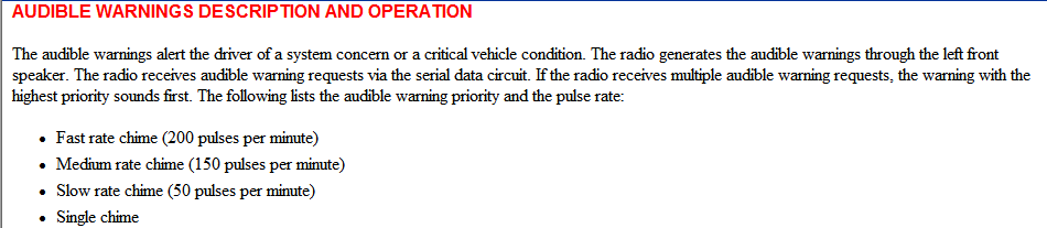

The turn signal click, is generated by the radio, since electronic flashers are inherently silent, the sound comes from a small speaker in the A pillar on the drivers side. You will hear the signal clicking stop, if for instance you get a seatbelt warning tone. This is normal, system is apparently not great at multi-tasking.
Old May 29, 2017 | 08:44 PM
Posts: 26,542
On a vehicle with the standard radio the chimes are heard only on the door speaker, since the tweeters are driven by the RIGHT speaker signal.
On a car with the premium sound system the chimes can be heard from the door and the tweeter, since the tweeters are driven by the individual Left and right speaker signal.
I can provide schematics if there are any questionS. Everyone is correct for their car.
From Mitchell OnDemand:

I've noticed that it only happens when the signal is used quickly in succession, for instance, getting on the freeway and then changing lanes less than 5 seconds later.
Old May 30, 2017 | 08:07 AM
Posts: 26,542
Then, that is because it hasn't finished one thing when another thing starts.
