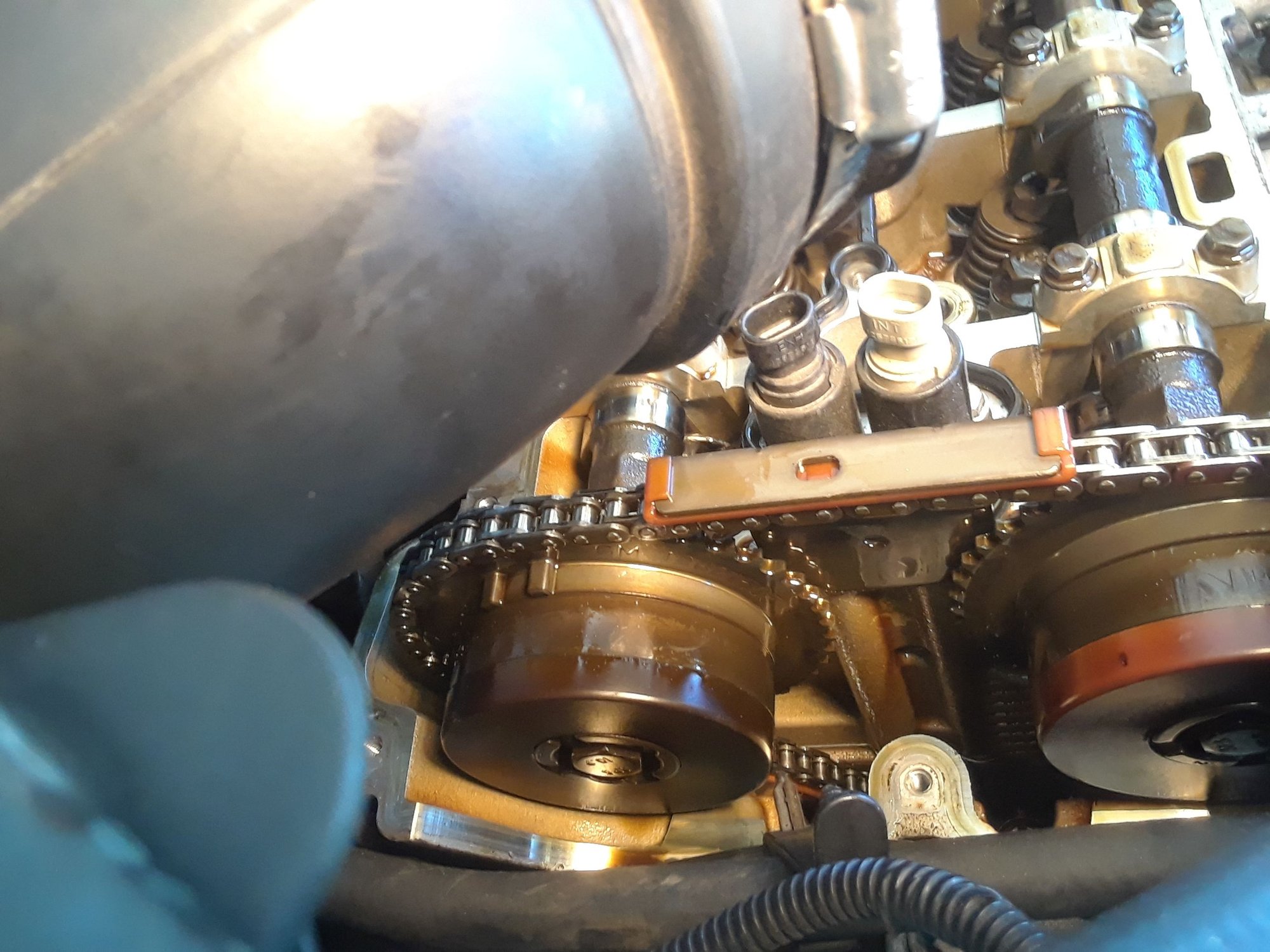

Removed the valve cover today, in preparation to replace the valve guide seals. The seals from ZZP showed up this morning, USPS. Waiting for FedEx to bring my tool, supposed to be today.
A little less satisfied with the mechanic's work in San Jose. He applied gasket sealer to the intake manifold, looks like the sticky stuff that you brush on.
It never had sealant of any kind before, don't know why he would take it upon himself to put it on. He didn't charge me for a new gasket, but he hinted that he was going to replace it. Maybe he didn't install a new one, and the old one leaked.
Next time I have to remove the intake, I'm going to have a mess.
The good news is that I thought my timing chain was a little loose, and I had planned on replacing it soon. But it's nice and tight!

The intake has 4 O-rings. He must be one of those old farts that puts gasket shellac on everything. Just hope he didn't put any silicone on it
