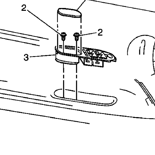

Thanks for the help. I read online somewhere that you can get to the switch by only removing the two screws in the pocket , and pulling up on the trim holding all the switches. Could this be?
Old Jun 2, 2017 | 11:31 AM
Posts: 26,533
Yes, sort of. I think the wire may be too short though.
There is is a tab thing in the front and a push clip thing at the rear.

Thanks Donbrew. I am not to excited about removing the door panel if I don't have to. Didn't I buy a radio from you a while back?
Old Jun 2, 2017 | 11:59 AM
Posts: 26,533
Not me.
IIRC, the wire is very short, so you may have pull the panel for working room. Really not a big deal with a plastic putty knife.

I removed the trim holding the switches. There is plenty of cable on all the switches so you can lift the trim out of the door panel and remove the plugs from the switches. It took longer to remove the mirror switch from the trim plate.
