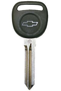

Does your new key match the original key, does it have the O with a + in the middle on the metal part of the key just below the black plastic of the key?
Like this one?
I found this video for adding a key if you have a working key already

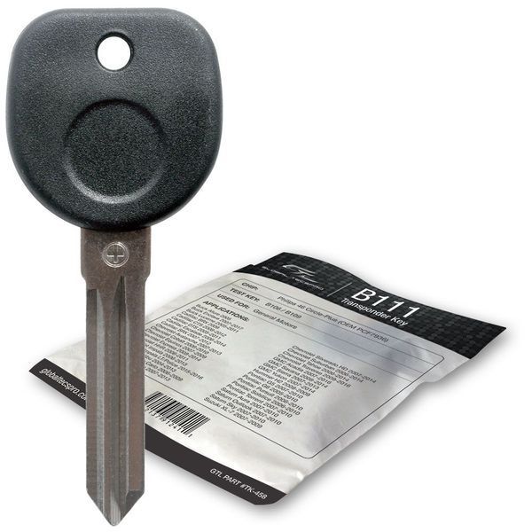

I bought the key on aliexpress and had it shipped here
It does have a transponder in it (I opened the case and saw there was a tiny plastic "box" seated in between the metal key.
Here's a picture of the fob and key I got
they also said it fits the hhr

1. Both of the pics show the "wrong" style key for the HHR. The HHR key should have the small keyring hole.(after the ignition recall of 2014)
In other words. Keys with the large keyring slot are NOT the recommended key for a replacement.
2. Allen P shows a pic of a key without the transponder marking........aka, most likely the wrong key.
3. And how did you "open the case " on the key ? The black plastic on the key is molded on. Not able to "open".

Yes, FMG small hole, but with the O with the + in the middle
Old May 1, 2021 | 09:52 AM
Posts: 26,485
If there is a transponder it is not The correct one. The + in a circle indicates PassKey 3 system, anything else won't work. It will serve as a door key.

--So sorry for not getting back about the key. turns out the key wasn't compatible (just like you said) so I was lucky enough to get 80% of the money back. Haven't tried anything with it, it's been lying around--Thanks so much for the advice
