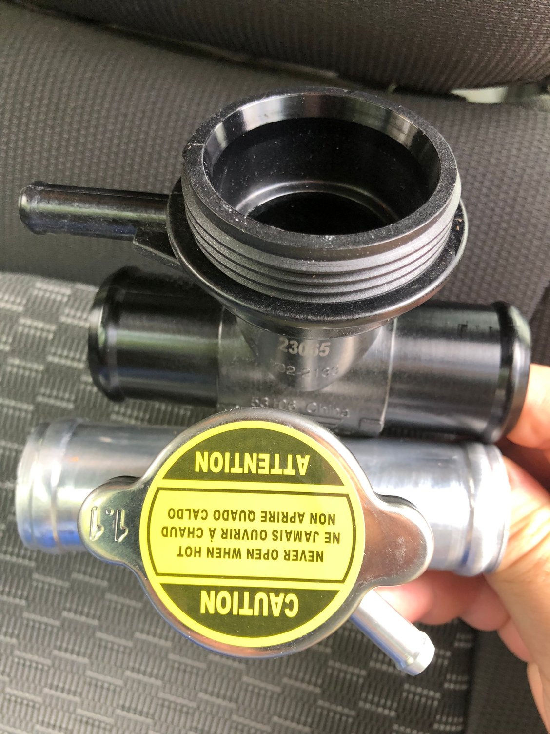

Here’s the results….
Alloy Filler Neck, New Koehler SS Hose Clamps, hose clamp for the overflow hose, a new front upper hose, and some Prestone Dexos.
The short block hose arrived today, so it will go on in the next week or so.
I found one difference in the new Alloy “T”, which is that the overflow spout is smaller diameter, so switching out the stock compression clamp with a screw on clamp is a MUST for the purpose of getting rhe circumference tightened. Otherwise, the compression clamp allows it to leak.
After measuring before I ordered the Alloy Filler Neck part, I realized that the 1:30 angle makes more sense, as it goes straight down the side where the inlet is on the overflow jug. The other side benefit is that there’s no snugging up of the front hose to the overflow hose. It just feels better when off to the side like this. Perhaps that 45° angle might offend some with OCD. However it seems more ergonomically swift.
The Alloy version is a little longer (about 1” longer), but doesn’t seem to create an issue. It is 2mm smaller diameter, but should be fine with good hoseclamps.
Here’s the OEM part. Snapped right at the junction.
Superior Quality you can feel!
Old hose holding old chunk of crumbling plastic
Job COMPLETE!
(*Note: this is after replacing the rad hoseclamps, but before changing out the compression clamp on the overflow tube to the screw-type clamp, which is a must, as I soon discovered after warming up to cap thermo open position.) The compression clamp allowed a slow drip).

Looks like the original problem resulted from over tightening hose clamps. There is a reason that those spring clamps come from the factory.
Hose clamps have torques specs.
The clamp should not dig into the hose or cause the hose to flare.
