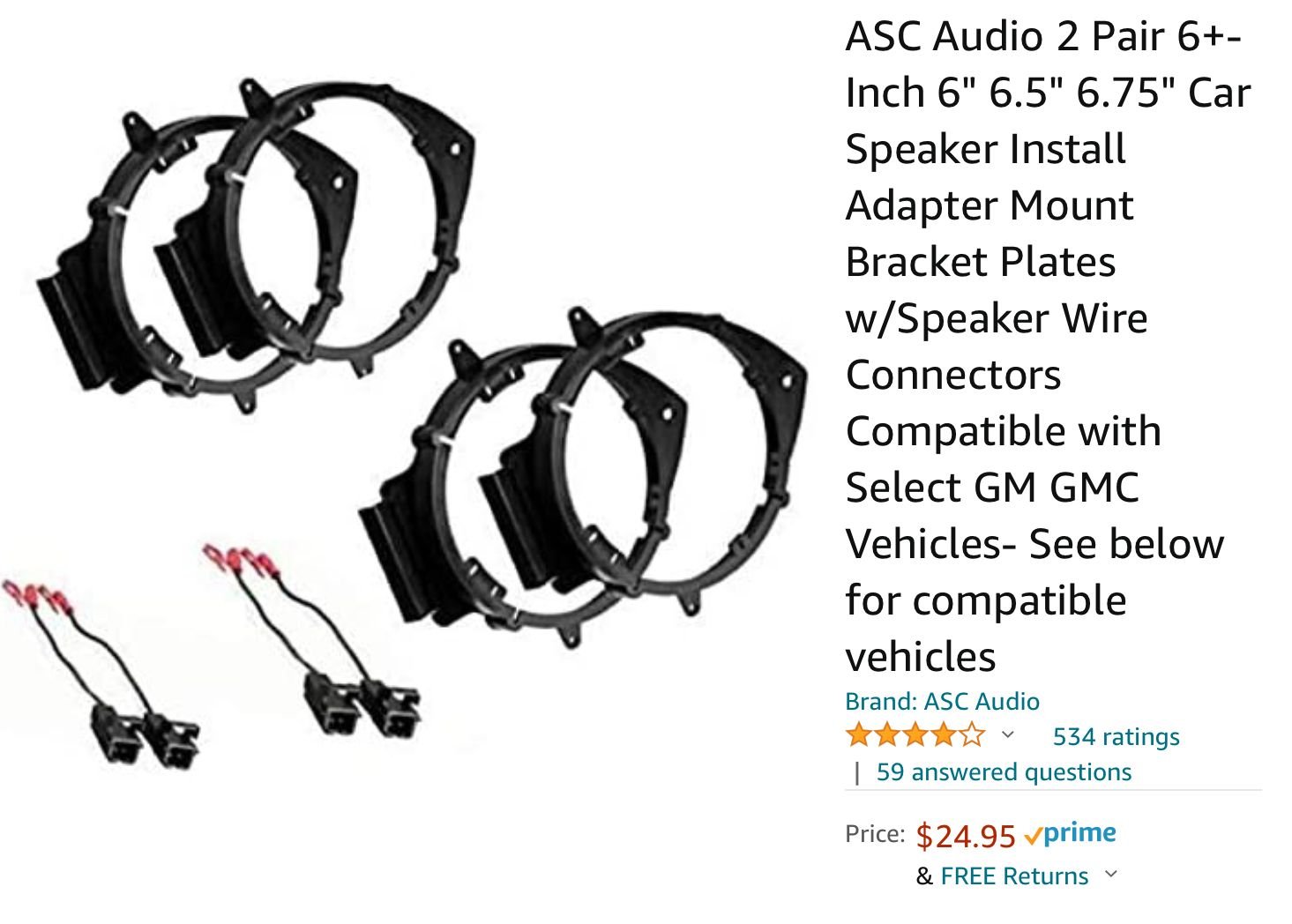

2, 3, or 4 "way" doesn't mean that much. More "ways" is no assurance of higher fidelity. The cheapie Kenwoods were "4-way" and sounded fine. The pricier Kickers were just "2-way" but sounded better. Also, your A-pillar tweeters will still be active, so high-register performance isn't that important.
I agree that 6-1/2" speakers are the better choice.
I bought these adaptors but haven't used them. Yet. I used a pair of the pigtails in a car that showed no corrosion on the connectors. That's not always the case.

https://www.amazon.com/ASC-Connector...d_bap_d_rp_1_i
Very good info Thank You !
On the Crutchfield I can get the rings.pigtails and cones so all the goodies I would need :)
Plus I have a tube of Dielectric grease that I will use to apply a Tiny dab on the connectors.
SO I will stay with the 6 1/2" speakers :) I am getting anxious now so will order soon and give me a Christmas present lol

Not very difficult to just cut the cones out of the old adapters and tie wrap the new speakers into them. Saves $20 for 2 minutes work.

I have been tossing that idea around! :) So the journey continues lol
