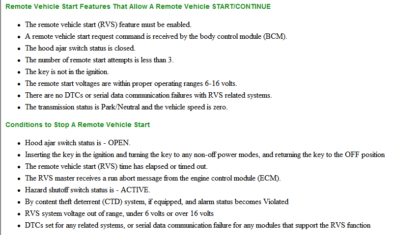

Here is a list of conditions fo the RVS to work, add the Hazard lights must be off.

RVS can be switched off manualy ? first point of the list. Or if i have the AB3 i have it always enabled ?
It seems that all points of the list i can check that are propper, but the engine still wont start

You still have engine codes, or the hood latch sensor is causing a problem, or the remote is disabled in the DIC

It can be disabled in the DIC personalization menu, or by turning the hazard lights on.
No errors in memory? The light does not have to be on.
