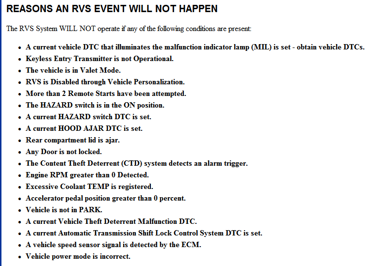

So the sytuation is like this. No errors no chec engine, FOB locks unlocks the panic buton works. All the points from earler list are positive i mean non of them should apper when i try to start the engine.
But i click 2 time on the lock button then the remote start, light blink but engine dosnt start. When im in vechicle after the side lights blink i can hear a click near the transmisson. But nothing happens.

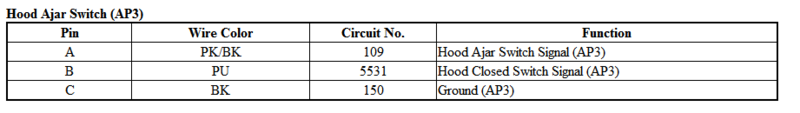

You have checked the hood ajar switch? When b is grounded a is not; when a is grounded b is not. So you are looking for continuity between a & c / b & c. The purple wire and the pink black both are on connector C1 on the BCM see:https://www.chevyhhr.net/forums/how-...ion-ap3-28551/ . I'm not sure where a goes to ground.
If you jump b & c the RVS should work if a is open.
