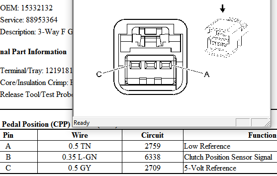

I would try grounding the lt.green wire in the plug. Disconnect the connector and run a wire from ground to the lt.green contact in the harness. Or, jump the lt green to one of the other wires one at a time.
The switch is a variable resister with 5V on the dk blue/white wire and ground on or/grn. I would try A to B first then C to B, if neither works ground B. Don't ground C or you will short the ECM.
Seems to be some different color codes, here is the connector pins.

oh dude. Thank you! Gonna try this immediately

nope didn’t start. But thank you very much !
