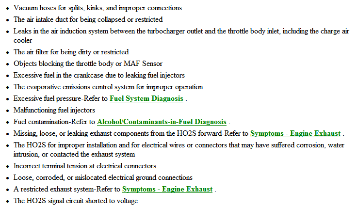

Posts: 26,536
That means vacuum leak. Too much air in the combustion chamber.
The full name is: fuel trim rich at cruise or accel. (when there is supposed to be boost.)
So, most likely one of the vacuum connections to the turbo. My guess is a vacuum solenoid is broken. Only a guess, I don't know anything about turbos.
Here is a list of things to worry about:

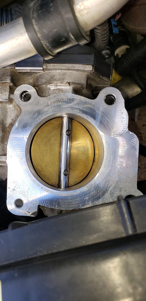

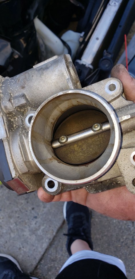

Took off front bumper. Upper radiator hose. Radiator mounting brackets and unhooked intercooler from one side and dropped it all down on the passanger side to take this photo
I got it off by just sliding the radiator and everything down and back.
All cleaned. We will see if this works. So far this morning i did another boost test to 20 psi. No leaks held air. Sprayed all vacuum lines with carb/tb cleaner to see if any leaks. No leaks. Now cleaned tb. Will see if any of this helps. Will do another boost leak test when i get done putting intercooler back on to make sure its not leaking

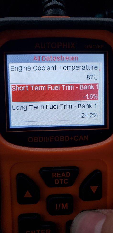

Welcome back rj. Well I got a new intercooler installed from Zzp and man how did you guys get your bumper to fit back on right? I have had this bumper off 5 times and it like does not fit with the new intercooler. Anyways it's install and my new vacuum tank is also installed. Just drove like 5 miles and got the p2178 again.. here's some things on my scanner that may help? I have no idea I'm still learning so bare with me guys.
This was at 0% the entire drive from what I could tell. Same with short term one on next picture.
This o2 sensor actually kept going to 0 volts under deceleration. EXAMPLE. Going downhill with no throttle on and no cruise. Short term trim ---- but my bank on next picture shows my issue
This is at idle.
This is the fuel bank that failed.
