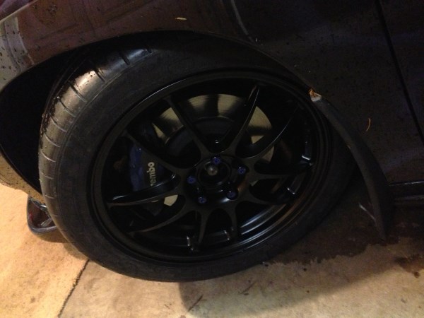

Here is an update, 245x45x18 fit also.........plug that into the tire calculator.
Old Dec 29, 2014 | 10:38 PM
Posts: 11,721
Wow. That's amazing they clear because I spec'd it at 26.68". I guess it's either the sloped edge of those tires or rim offset. Or both.
(Even more amazing is it only took the OP 9 months to come back and say "thanks for the info".
To be fair, at least he did come back with the thanks. It is appreciated. )

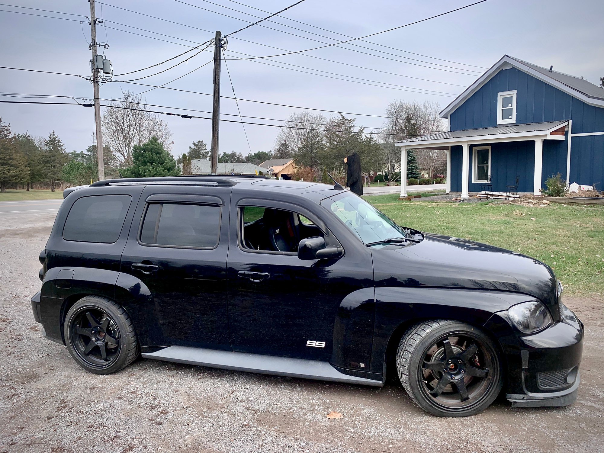

18x9.5+22 varrstoen Es2’s and 245/40/18 falken rt615k+. Probably going 275 in the front next time.
Just bought these for the fronts, going to use them with a 24.5 x 8.5 x 15 slick
