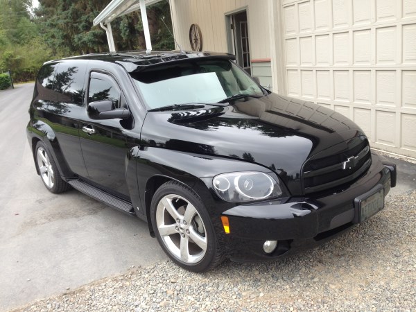

Sounds like you have the stuff right, I have run up to 255x40 on them. Switched to 235x45....like them better.

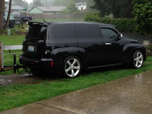

Your welcome 08racer. They have migrated to the panel with some 235x45

Yes it has YYZv1's with KYB struts, rides and corners great for the daily driver.
Not so low that it cant do some work.
