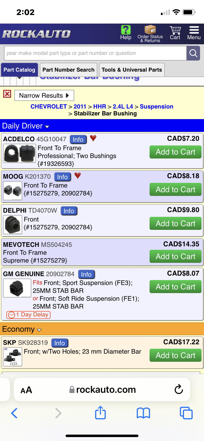

Old blue yes this is correct 25 mm given the fact that the conversión from 1 in to mm is slightly different.
My assumption is that since non OEM it is not the most adequate and I will have to buy the AC Delco ones .
Old Nov 13, 2021 | 01:05 PM
Posts: 39,979
I’ve tried the 1” poly bushings from energy suspension and they were loose made noise, I tried Moog , to small in the bracket, I went back to AC Delco, you get 2 for under $10.00
Note that is just $7.20 CDN funds! For those AC Delco bushings, clean the bar of any dirt and grease, install them clean , no grease! With the split facing to the rear of the car.
