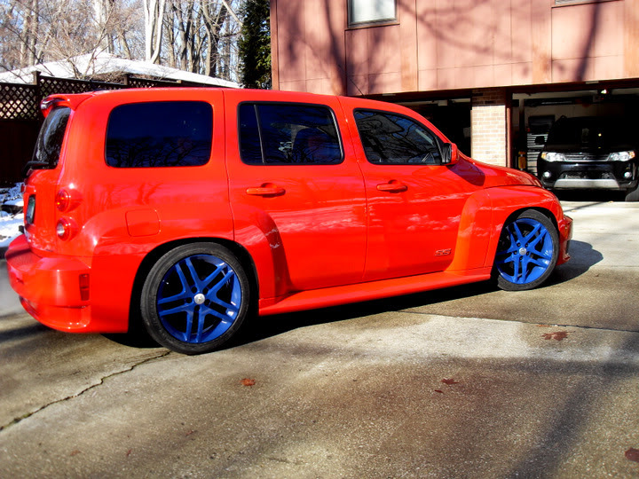

A 200 mile round trip every day would get down right miserable with a poor suspension. Honestly, to go as low as you're wanting, you'd have to go with a coilover system and for that kind of driving, I wouldn't personally do it. For short aggresive driving the coilovers would be nice. As for springs, the lowest you'll go is on a set of first gen Goldlines which are literally "gold" these days as it seems since there's a new add in the classifieds weekly with someone looking for a set. The next best option is what I've got on mine...Canucks for the SS Cobalt. I've got about an inch gap up front...inch and a quarter or so in the rear. As for ride, it's not bad...of course I have bottomed out on speed bumps but I've learned to go very slow over them. If you want to sit your wagon on top of the fender I guess you could always just cut your factory springs...save you some money and get the drop you want...especially if comfort and handling is least of your worries. Take it to a shop and just have them torch 2-3 coils off the springs and slap it back in.
Here's a pic of a close up of the gap I've got with my Canucks...

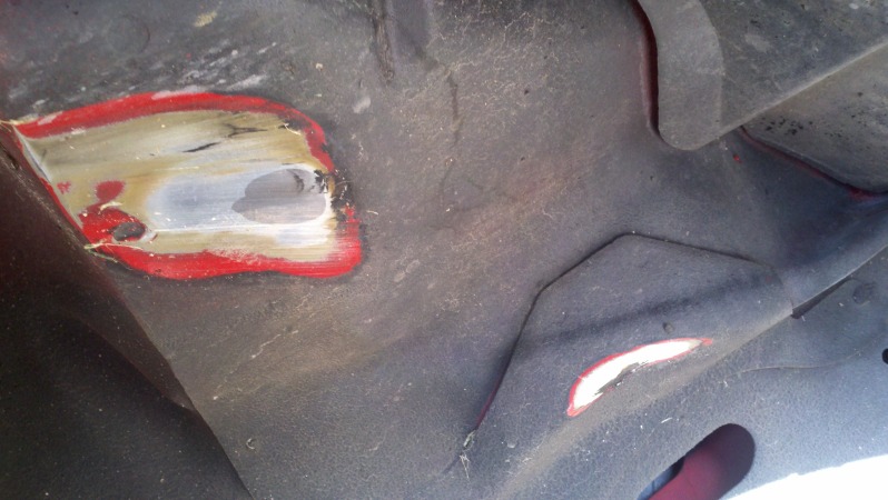

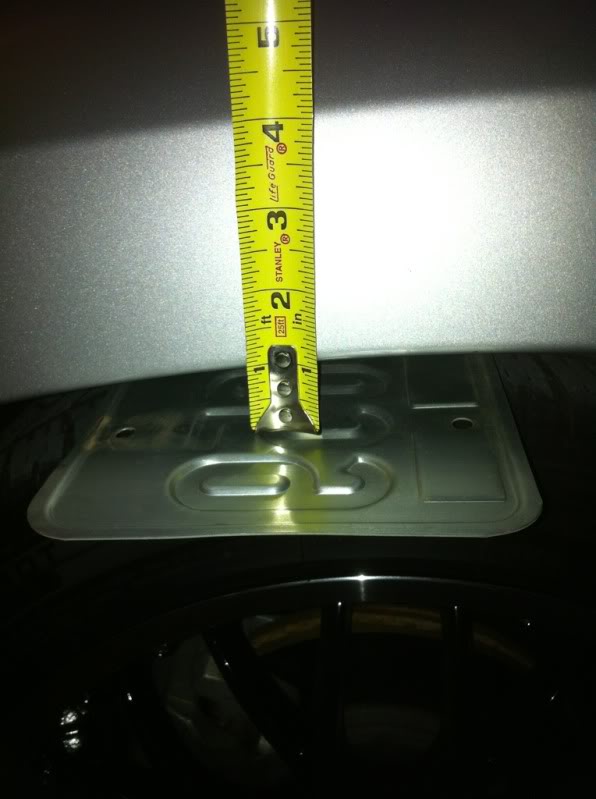

This:
='d a little rubbing:
Only at full lock though, some bumps.
I've since raised it so I can enjoy the "handling" once more.
