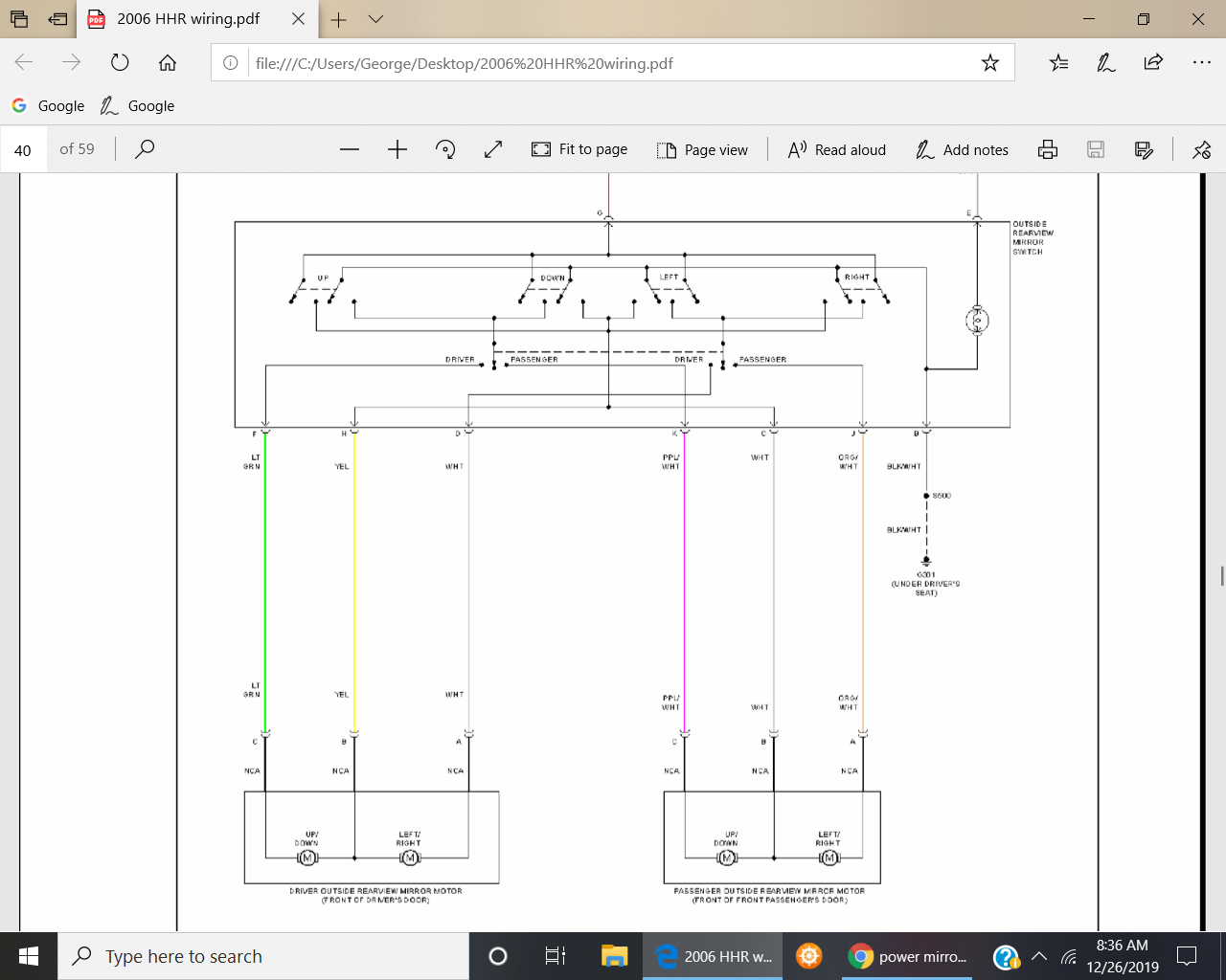

Any chance you could re-post this diagram at a higher resolution (I.e., larger) so that it is legible? Thanks!

It could be a loose wire or other connection, but it’s very probably the relevant contact in the driver/passenger selector switch. I was able to disassemble the switch assembly and clean the contacts in an ‘08 LS.

Here's a different schematic. Maybe it will help.
(red wire cut off at top, goes to the mirrors fuse)
